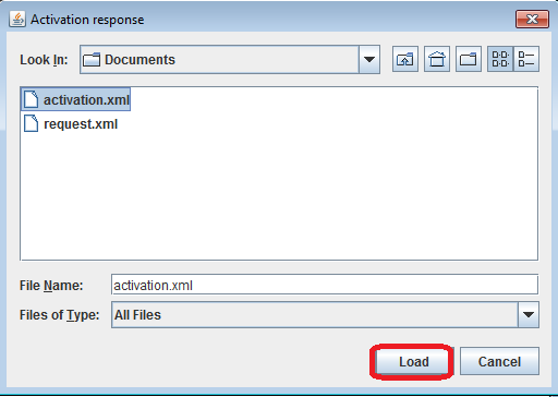

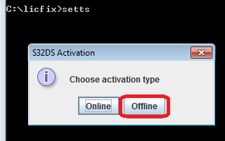

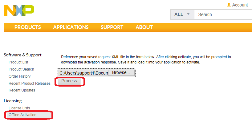

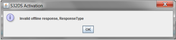

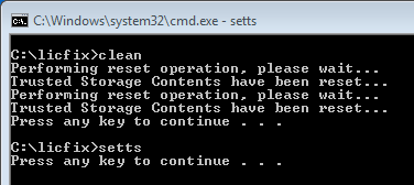

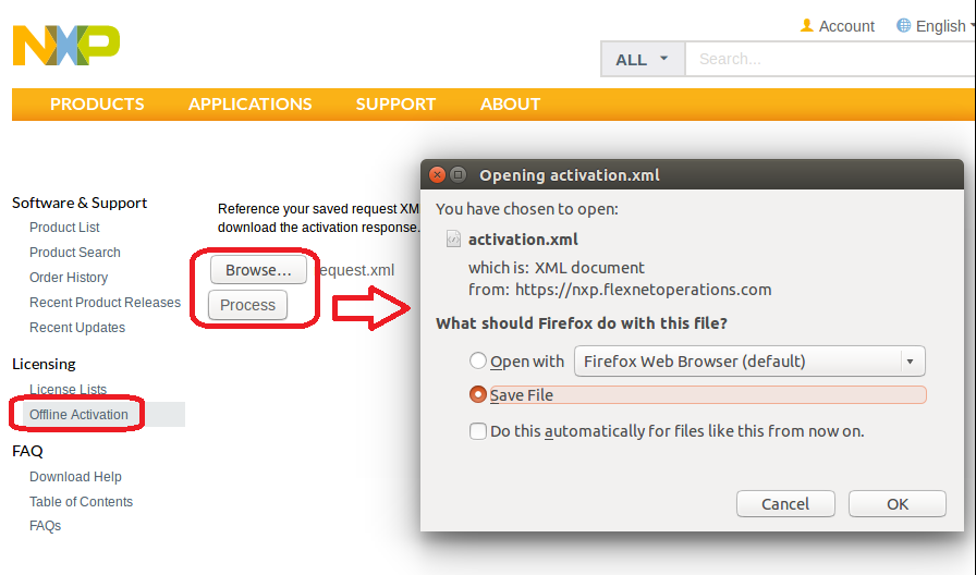

When installing S32 Design Studio using the offline activation method (Offline activation on S32 ) the installer may pop up an error dialog: " Error: "Invalid offline response, ResponseType"." This typically occurs on the computers that have no previous installation of S32 Design Studio.
S32DS for ARM v1.1, v1.2, v1.3
S32DS for Power v1.1
S32DS for Vision v1.0
Newer versions should include the fix already.
Option A) Easiest solution is to use online method instead of offline. But in some cases it may not be possible (LAN restrictions, computer is not connected to the Internet or there is some other network obstacle etc.)

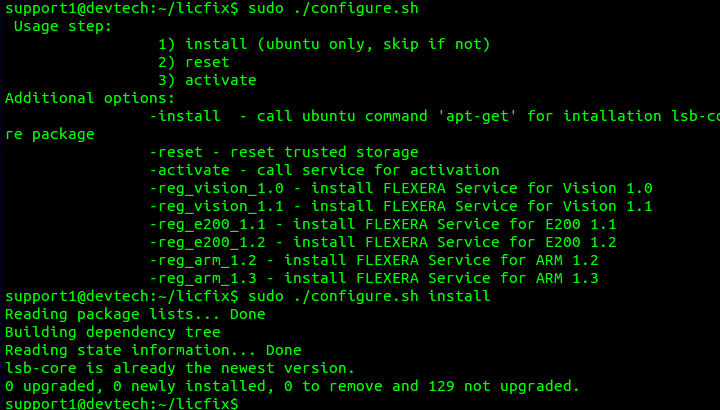

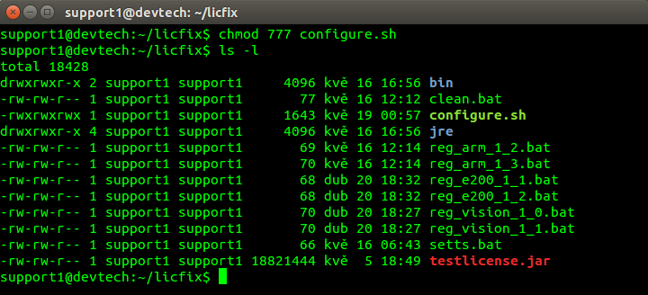

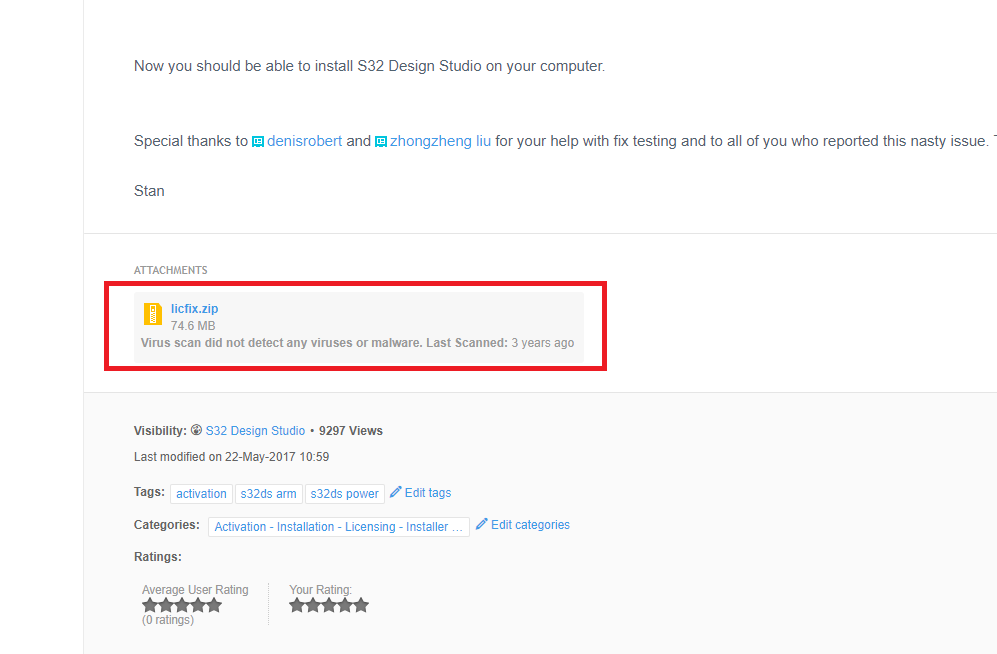

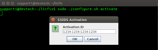

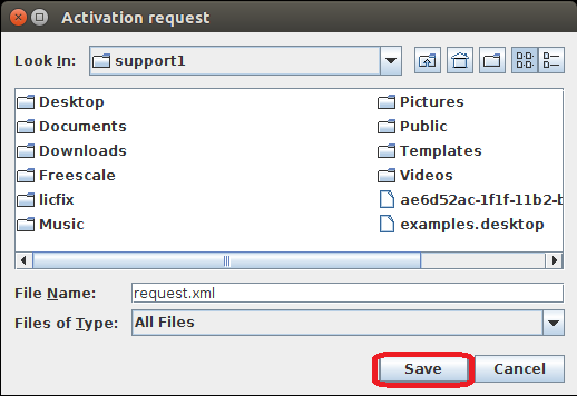

Option B) Apply the hot fix attached. See the instructions below how to proceed for Windows and Linux (Ubuntu) users
chmod 777 configure.sh
sudo ./configure.sh install
sudo ./configure.sh reset
sudo ./configure.sh activate
Now you should be able to install S32 Design Studio on your computer.
Special thanks to denisrobert and zhongzhengliu for your help with fix testing and to all of you who reported this nasty issue. Thank you!!!

Hello Stan
I've tried this method,but it didn't work. It seems that the license can not be detected,and I still need to enter an activation code, but I got "Activation ID is already used on this station", could you help me?
Michael Von
Finally I solved this problem!
The ID I used before is unavailable,I ran licfix with ID:C699-XXXX-XXXX-E800 , after this process ,the installtion succeeded.

Where is the "HOT FIX" attached? ........ as described above?
Please check the bottom of the original message.

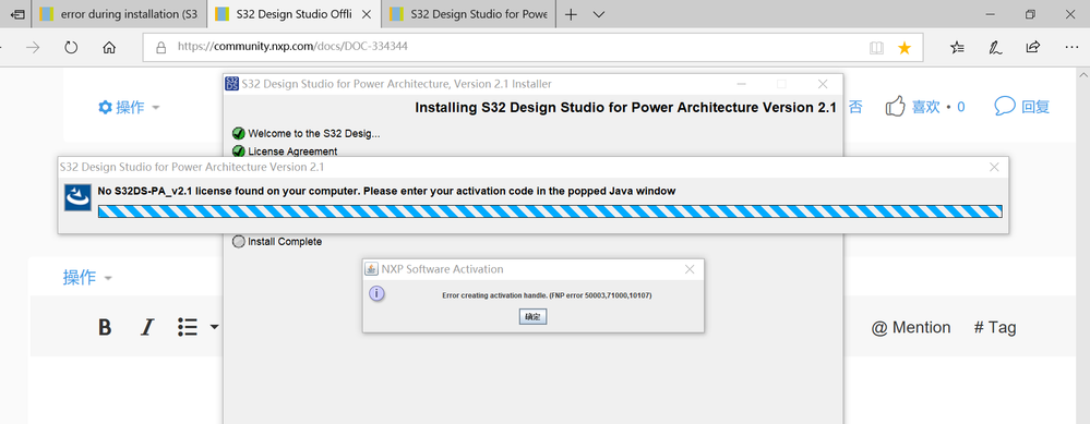

Sorry to bother you.
I also encountered problems with the installation(S32DS_PA V2.1).
I also tried the relevant solutions in the community, but I couldn't solve the problem.
Thanks in advance for your help.
Hello I'm trying to dlownload for a previous version v2.0 and v2.2 is already installed on my local pc. so when I'm trying to get the activation xml file it is giving me this error message again and again. Can anyone please help me on this?
