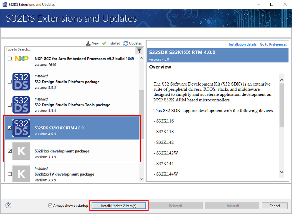

Installation instructions
The update is available for online (via Eclipse Updater) or offline installation
  •  online installation:
    • go to menu "Help" -> "S32DS Extensions and Updates" dialog
    • select from available items and click "Install/Update" button
  • offline installation:
    • go to S32 Design Studio v3.3 product download page: S32 Design Studio for S32 Platform -> Downloads, click 'Download' button next to S32DS for S32 Platform v3.3, then select 'S32DS.S32K1.3.3.0_D2006.zip' to download the update archive zip filepastedImage_2.png
    • Start S32 Design Studio and go to "Help" -> "S32DS Extensions and Updates"pastedImage_12.png
    • Add a new "Add.." S32DS Software Site and browse to select the downloaded update archive .zip file you downloaded in the previous steppastedImage_6.png
    • Select from available items and click "Install/Update" button.pastedImage_3.png
This will start the update installation process.

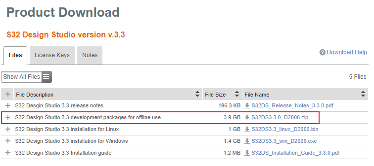

Hi Mike Doidge,
Customer report the 'S32DS.S32K1.3.3.0_D2006.zip' is not able to download.
I can not find this file at S32 Design Studio v3.3 product download page too.
Would you please check it?
Robin
Hi Robin,
You can download this update package directly from the following link, no any account login required:
https://www.nxp.com/design/software/development-software/s32-design-studio-ide/s32-design-studio-for...
or click the link to download it: S32 Design Studio 3.1 Update 2 D2006(REV UP2_D2006)
Thanks~!
Best regard,
Enwei Hu.
Hi @Robin_Shen & @enwei ,
During the time since this release was published, the content of  'S32DS.S32K1.3.3.0_D2006.zip' was moved within 'S32DS3.3.0_D2008.zip'
Mike
