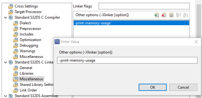

Right-click on the project name in the Project Explorer panel and select 'Properties' from the menu. Navigate to the C/C++ Build -> Settings ->Standard S32DS C Linker -> Miscellaneous menu. From the Other options section, click Add.
In the 'Enter Value' pop-up menu, enter:
-print-memory-usage
Click OK, then Apply and Close.

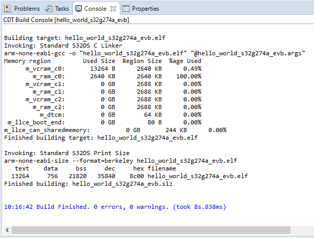

Now build the project and see the memory usage information displayed in the Console window.
