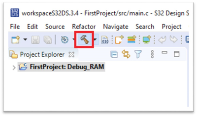

  1. Build the project.

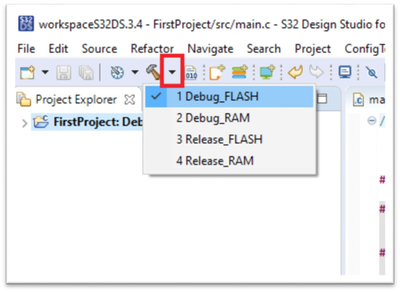

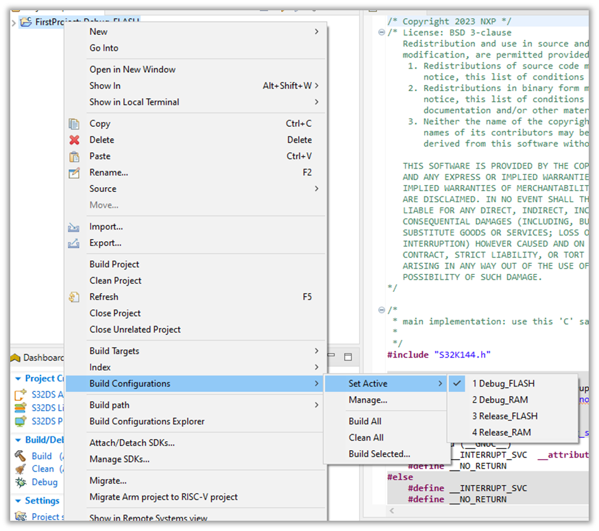

    • Select the build configuration. (optional)
If you already know which build configuration is desired, you can preselect it. If not, one is already selected for you by default. It will be noted with a check mark. Typical options contain choices between RAM and FLASH memory builds and for each a choice between Debug and Release. For debugging purposes the Debug option should be selected.
  • Click on Build. Clicking this button will start the build using the preset build type.
Or, select the build type from the pick list. This will start the build for the build type selected, regardless of which one is marked with a check mark.

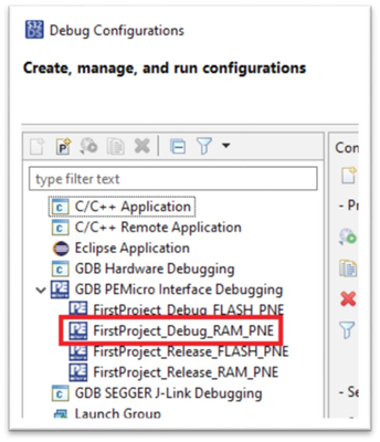

  1. Configure the debug configuration to start a debug session.
    • Click ‘Run’ pulldown menu.
    • Select 'Debug Configurations…'
  • Select the debug configuration associated with your current build configuration.

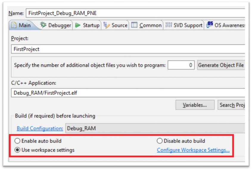

  • Select whether to rebuild code each time debug session start is requested.

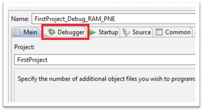

  • Click on Debugger tab.
  • Verify proper interface and port.
  • Click Debug
