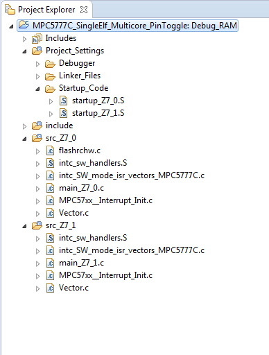

This Example demonstrates an alternative way to multi-core projects. This is basically a single eclipse project that generates the single elf file for dual core MCU (MPC5777C)
See the project structure below where the sources for each core are separated into a core specific source folder:
Main core0 [e200z7_0] performs basic initialization (Clocks, ports..)
Each core initializes the interrupt controller in order to service interrupts generated by PIT (Periodic Interrupt Timer):
Core 0 (e200z7_0) services PIT channel 0 interrupts generated once per second.
Core 1 (e200z7_1) services PIT channel 2 interrupts generated once per two seconds.

Thanks for posting. How do you create such project using the S32 wizard? Is it possible? Is having only one elf a problem to debug multicore using Lauterbach (I am still waiting for my debugger head)?
I am new to NXP toolchain :smileyhappy:
Hi Frederico,
Sorry about delay. This project has been created manually - It cannot be generated by the New Project Wizard.
Anyway if you place this project into the example folder "<S32DS for Power>\S32DS\Examples\MPC5777C\" then you can use it as a template for your own projects:
Lauterbach TRACE32 supports multi-core debug and having just a single elf should not cause any problem with TRACE32.
The only difference is in a script that programs the device that flashes just a single elf instead of sequence of multiple elf loads.
