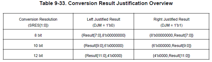

I use MC9S12ZVML128_PMSM (single shunt).
And I wonder that meaning of <<The results are stored in memory as 12-bit (ADC0FMT_SRES = 4; ADC1FMT_SRES = 4) left-justified data (ADC0FMT_DJM = 0; ADC1FMT_DJM = 0)>> in manual.
what is meaning of <<left-justifted data>>?

This is described in the Reference manual.
See Chapter 9.5.2.5 ADC Format Register (ADCFMT)
If ADCFMT_DJM = 0, data are left-justified in the conversion result list.
Then in Table 9-33, you can see the justification.
If left justified, the result is stored in the most significant bits.
