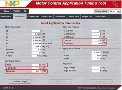

Hello, the code in the official program of s12ZVM single resistor
#Define I_ PH_ Over FRAC16 (0.933333333333)
#Define TEMP_ Over FRAC16 (0.170489770614)
What does this current and temperature actually represent? How to convert? Do you have any relevant program introduction documents
1,366 Views
tomasfedor
Hi Zhouqicheng,
In order to explain it I will use files form S12ZVM PMSM Development Kit sw
https://www.nxp.com/design/development-boards/automotive-motor-control-solutions/magniv-and-s12-solu...
I_PH_OVER and TEMP_OVER are located in PMSM_appconfig.h generated by MCAT tool.
MTRCKTSPNZVM128\sw\AN5327_SW_CW10\FreeMASTER_control\AN5327_PMSM_FOC_Sensorless_SingleShunt.pmp
Values are scaled in FRAC16 format since fraction arithmetic is used.
in case of S12ZVM PMSM Development Kit sw:
#define I_PH_OVER FRAC16(0.4650000000)
#define TEMP_OVER FRAC16(0.1704897706)
in order to get physical value we need to apply scales
I_PH_OVER * I max = 0.465 * 20 = 9.3A
TEMP_OVER* Temp max = 0.1704897706 * 645.2 = 110 deg C
for more information I recommend application note AN5327.
