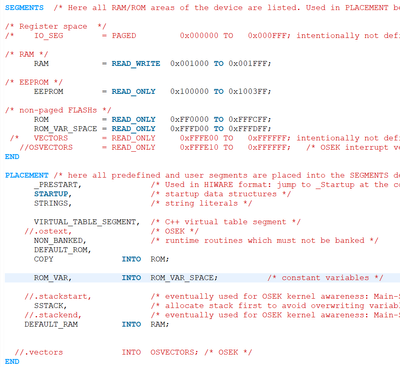

I'm trying to place a variable  in an absolute flash location. Target is S12ZVM and I'm using codewarrior.
Can you help me with some reference for this scenario.

You need modify the *.prm file for this MCU – select such FLASH space for this variable:
In “SEGMENTS” define “ROM_VAR_SPACE” (I selected small part of FLASH);
Then in “PLACEMENT” tell linker ROM_VAR data must be placed to ROM_VAR_SPACE.
Then in main.c use:
The ROM_Variable is the variable saved in defined FLASH position.
I hope it could help you.

But after building the project, the ROM_VAR_SPACE area is not getting reflected in the .sx file.
Is this expected one? For the ROM_VAR_SPACE area to get reflected in .sx file, what I have to do. Could you please help me on this.?

Sorry for my mistake – it has to be used:
#pragma DATA_SEG ROM_VAR
Then define such data… and at the end use:
#pragma DATA_SEG DEFAULT
The CODE_SEG saves the functions and the DATA_SEG saves the data.

But I was using the DATA SEG only and not CODE SEG, as you have mentioned in the previous screenshot.
Please find my .prm file and main.c attached.
