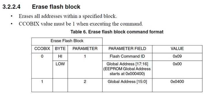

When I call the below function,the all eeprom(0x400-0x13FF) is erased and the MCU reset.Please help me.
void Eep_EraseAllEeprom(void)
     FSTAT =0x30U;                /*Before launching a command, the ACCERR and FPVIOL bits in the FSTAT registermust be clear*/
     FCCOBIX = 0x00U;
     FCCOB = 0x0900U;          /*the Erase flash block command is 0x09*/
     CCOBIX++;
     FCCOB = 0x0400;
     FSTAT =0x80U;                /*FSTAT register (to launch command)Clear CCIF 0x80*/

Erase block command is one of Mass Erase commands. And if you look at 29.4.5 Allowed Simultaneous P-Flash and EEPROM Operations, you may notice that P-flash simultaneous Read from P-flash and Mass Erase EEPROM is not allowed. Effect of this is that P-flash is not readable while Mass Erase command is applied to EEPROM block. CPU is unable to read code (and interrupt vectors) from P-flash  and runs away. You need to either use sector erase command and iterate with it over entire EEPROM array, or move parts of your code from P-flash to RAM.

Sorry,the MCU is not reset,but the BDM
output ILLEGAL_BP,and the PC jump to a invalid address.

thanks a lot,i understand!
