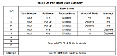

Hi is it a way to use port M 2345 as an input while using the can TX RX ?
And is it possible to disable internal pull up on PB4 and PAO ?
I tried already PUCR but no success.
Thank you

1) Of course you want to use only CAN. The peripherals are defined for sets of pins not for entire port. So if you use CAN then CAN setup registers control pins assigned for CAN.
2) Setup for input pin at PM[5..2] as input pins.
DDRM &= 0B11000011;  // PM[5..2] input pins
RDRM = 0x00; // default…full drive
PERM |= 0B00111100;  // enable pull device at PM[5..2]
PPSM &= 0B11000011;  // connect pull up to PM[5..2]
3) If the pull resistor is not connected and the pin is set as an input pin then it is in high impedance. So, if you read it then it is not clear what you read. It can be anything.

If the pin contains more alternative functions then, table Table 2-1 Signal Properties, defines priority and the priority is from left(lowest) to right. If more peripherals are enabled at the pin then the peripheral (with highest priority) setup takes precedence over all others. So, the CAN has it own setup.
It is not possible to use these pins with more peripherals. However, there is a PTIM register which can be read in any mode. PTIM …. Port M Input Register — This register always reads back the status of the associated pins. This also can be used to detect overload or short circuit conditions on output pins.
PB4 and PA0… no for individual pin but only for entire port in the PUCR register. The pull resistors are disabled at port A and port B by default after reset. So it is not necessary to do anything to disable them. The question is how you test pull resistor presence. The pull resistor can be implemented in connected device.

"It is not possible to use these pins with more peripherals. However, there is a PTIM register which can be read in any mode. PTIM …. Port M Input Register — This register always reads back the status of the associated pins. This also can be used to detect overload or short circuit conditions on output pins."
Port M. On 48 pin is can TX RX. And all spi pins. I am not using the spi pins but I use the can ones. I try to use the other spi pins as inputs for some rotary switch to switch between tables. But even if I set them as input in the DDRM. They don't work as an input.
With a pull up circuit and a switch to gnd they don't change anything in the PTIM register.
I will try to use them as output to see if it's a question about setup. I read in some cases they are forced to be input or output but it's not clear in the datasheet.
About the PA0 and PB4 I know pull up are enabled because I tried it physically. I use a dragonfly board to a broad to build prototype circuit. The PORTAB register give me 0 and 1 when I put the pins at the ground and they read 5v continually. I disabled both pull up in the PUCR but it have zero effects.
Maybe have something that I am missing there.

danielmartynek
Hi @Yaban,
I'm sorry for the delay.
I'm still not sure how you tested it. If you connect the pins to either VDD or VSS, it will always drive the pin to VDD or VSS because the internal pull device is weak.
Try connecting the pin to VSS via a resistor. If the pull-up is enabled, you will measure positive voltage at the pin.
