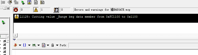

Dear Lama:
      thanks for your reply.
      but the question what occur to me is  when I debug my project the IDE told warning L1128. your reply let me know the reason of the warning is FAR_DATA is not defined.
      but I still dont now why does the FAR_DATA couldnt be defind.
      last day I have asked the question "How to use PE to initialize Xgate",a good man tell me Codewarrior dont support this function. so I use PE to build a project and disable pe create the prm file ,transplant a prm which is from a projct could use Xgate to handle interrupt. when i finish that,all the function could be used , the interrupt could be handle by Xgate too(although the debugger of Xgate couldnt use ).
     but the warning L1128 occur. I find the FAR_DATA have not been defined in start12.h.(But another project's FAR_DATA has been defined )
   my IDE is codewarrior IDE 5.1  the MCU is mc9s12xet256maa
   look forward your reply
