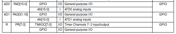

See also Table 2-2. Pin Functions and Priorities:
If there is more than one function associated with a pin, the priority is indicated by the position in the table from top (highest priority) to bottom (lowest priority).
So, the PAD pins are by default configured as AD pins. When we want to use them as digital input, we have to enable digital input buffer in one of ATDDIEN registers (ATD0DIEN or ATD1DIEN)

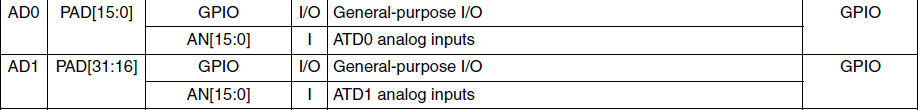

Thank Radek Sestak for above information, still, I have one more doubt in the same Table 2-2  if you observe the last column
then what does it mean? You said earlier (in above reply ) by default it acts as ATD input Pins but it says It will act as GPIO after Reset.
Am I understand it wrongly? If, please correct me.

Hi Hari,
You are right, good point.
Port AD is the quite special case. In fact, we can say that pins from AD port are GPIO pins with analog measurement capability.
So, you may still use them as digital input, digital output and even in these cases you may measure a voltage at these pins. This may be sometimes useful for example for overcurrent detection.
So, there isn’t any real priority between analog and GPIO functionality.
We can expect that some analog voltage will be connected to AD port pins. Therefore, the port AD pins are by default configured as input analog pins = with disabled input digital buffer. The voltage around VDDA/2 at digital input pin may cause increased power consumption (valid for all digital input pins). On another side, the enabled input buffer with pull-up/down may also affect ADC measurement results.
We may switch these pins to digital output mode by editing DDRAD registers anytime.
