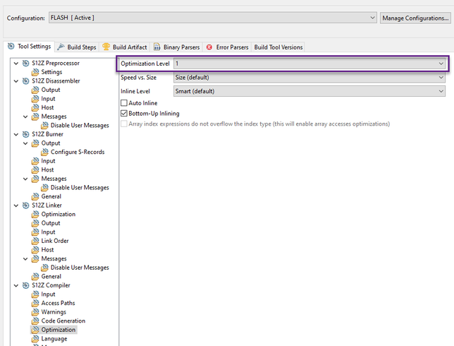

Indeed the compiled code is too big.
Have you tried increasing the size SHADOW_ROM_S and SHADOW_RAM_S sections:
You could also use a higher optimization level:
