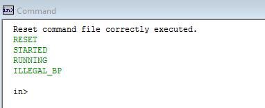

      I config  S12G128 with PLL and MSCAN.when I dubug by P&E_Multlilink_USB ,s12g128 enter stop mode and bring about "ILLEGAL_BP" like this:
      Does it reset?It is normal or what's wrong with it? It is on going run ,but Idonot know where it run?
      I config PLL with frequence PLL = 32MHz , BUS = 16MHz,VCO = 32Mhz.

danielmartynek
The debugger is disconnected when the MCU enters the stop mode.
To verify that the MCU is in the stop mode and wakes up, please use ECLK.
ECLKCTL_NECLK = 0; // Bus clock on PS7.
Bus clock is gated off in the stop mode.

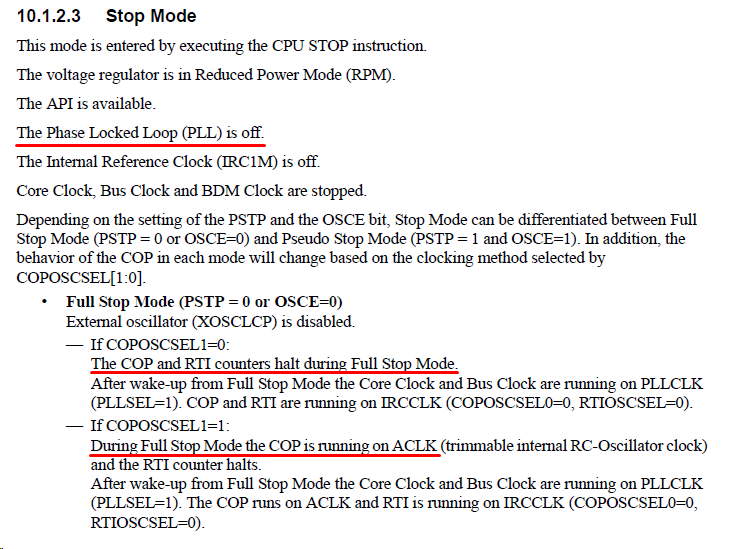

Hi,thank you for your help.I still have two questions.
1.   MCU enters the stop mode successful. And the power consumption (strom ) reduce reduce from 23.45mA to 6.91mA, it still cannot meet request for  a few milliamps. I have close the power of external device,what can I do to reduce MCU's  power consumption? adjust  PLL or others?
2.   I add watchdog function.before MCU enter stop mode ,it work well. But,when MCU wake up from sleep by CAN, it run away,I don't know what happened to it?
Shanwen
832 Views
danielmartynek
Is the COP working in the stop mode? PLL is OFF, but GPIOs maintain their states in the stop mode.
Are you sure you are not driving anything?
You can use an interrupt catcher (attached) to see which interrupt is actually called.
