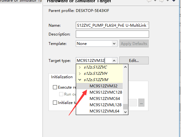

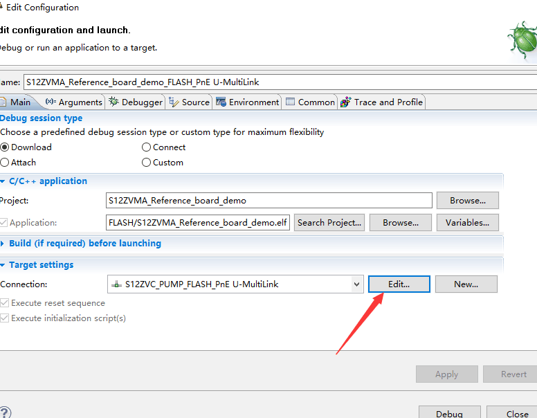

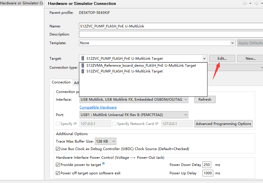

You can follow next steps:
1.click "Debug settings"
2.click "Edit"
3.click "Edit" too
4.choise"MC9S12ZVM32"
and you can download your code now.
