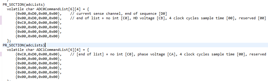

I use the S12ZVMC128 chip, and i want to PTU to trigger  ADC , then get DC current.
But when i set  ADC CommandList  as shown  below ,   (0xD0 is the channel of DC current) , the results in ADCResultList  are different.(DC current is constant.)177644_177644.pngpastedImage_1.png
what's more, if i don't use the module as shown below ,the results of DC current   I get    are   zero.

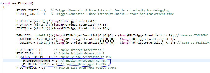

xiangxu860
I have found some problems in my code .
I haven't setup the PMFCFG2  register  in the initPMF() , and it's setup as below in the demo code.
now i can get signals in  the pin as below.

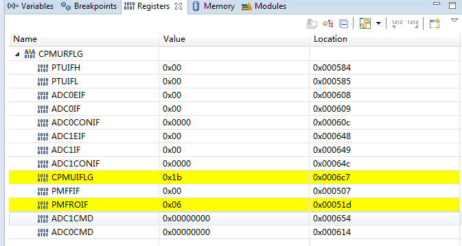

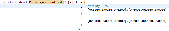

but now i have some other problems. the PTU trigger doesn't occur  at what i setup in the PTUTriggerEventList.
and i can't get into the for loop in main function  after the program initialization. then i check some flag registers as below .

there are no errors in ADC1EIF and ADC0EIF.
i think ptu  doesn't work at all . I can't get any signals in pins.

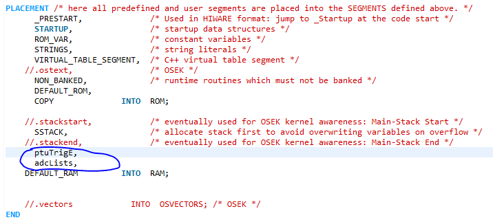

1,   I modified  my own project ,according to the software of development kit.
2,   I configure the register as follow to  get the stable current.(single bridge PWM)
      PMFOUTC =0x34;
      PMFOUTB = 0x2A;
3,   memory allocation is configured in the mc9s12zvmc128.prm  file.
