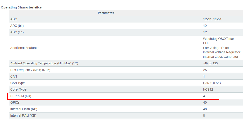

Hello everyone ,
I find  the different size of EEPROM onf different DOC, on the date sheet at here http://cache.nxp.com/files/32bit/doc/ref_manual/MC9S12GRMV1.pdf?pspll=1  , it says 1.5K,
while on this DOC, it says 4K, http://www.nxp.com/webapp/search.partparamdetail.framework?PART_NUMBER=S9S12GA48F0MLF
Could you please tell me the correct answer .ASAP.
Thank you very much!

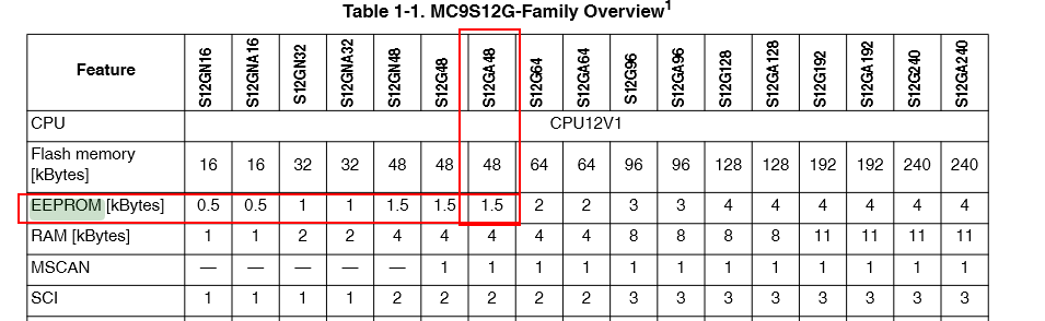

Hi fan,
The correct information is in reference manual.
S12GA48 have 1.5kB EEPROM.
Thank you for report of that inconsistency on our web pages.
I hope it helps you.
