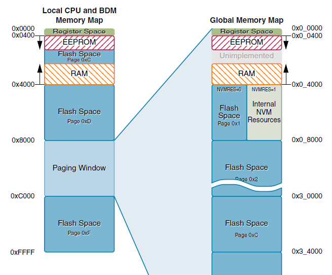

I create a project on MC9S12G** with BANKED model.
There is a structual type variable  EMS_infoMapS, its address in page is 0x8000, global address is 0x04000, logic address is ox18000(page=1).The following picture is S12 memory map.

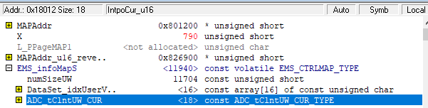

Then, I do the following operation,
void ADC_GetAnagValue1(void)
DisableInterrupts;
ADC_tClntUW = IntpoCur_u16((uint16 * __far) &ADC_tClntUW_CUR,ADC_tClntRsUW);
EnableInterrupts;
const uint16 *__far MAPAddr_u16;
uint16 IntpoCur_u16(const uint16 * __far MAPAddr,uint16 X)
MAPAddr_u16_reverse = MAPAddr;
I debug, and find MAPAddr is wrong.
I dont konw why MAPAddr is but 0x801200 not 0x401200, it is a wrong result.
How can i get ADC_tClntUW_CUR's true global address?

1. First of all which how big flash is in your device? PPAGE=1 is available only on 256k device. On 128k device the least PPAGE is 8, G64 - 0xC and so on
2
#pragma CONST_SEG MAP1_ROM
volatile const EMS_CTRLMAP_TYPE EMS_infoMapS=
Allocating data outside of CPU native 64k address space, you need to tell compiler how that data should be accessed, you need to specify either __FAR_SEG or __PPAGE_SEG
#pragma CONST_SEG __FAR_SEG MAP1_ROM
__FAR_SEG will probably trigger C3803 warning, but it is OK. __PPAGE_SEG will limit your data usage from nonbanked functions only.

1. The size of Flash of my device is 240kB, I am sure it support PPAGE=0x01~0x0F.
2. I read AN3784 Understanding the Memory Scheme in the S12(X) Architecture yesterday the first time, I find I know too little about keywords __far and  __RPAGE_SEG/ __EPAGE_SEG/ __PPAGE_SEG/ __GPAGE_SEG. Your suggstion '#pragma CONST_SEG __FAR_SEG MAP1_ROM' is totally right. I am sorry I make such a low-end mistake and cost you a lot of time.
3. ADC map is s part of EMS_InfoMap, and they are in the same page. EMS_InfoMap is at 0x004000(global address), ADC map is at 0x004012(global address). They are related by pointer. I think the detail for this answer is not important now, because part2 is the most important.

2. Actually you have two ways to tell compiler your data has special, not 16bit address. Keyword like __far in data declaration or round your declaration with proper pragmas. If your data is shared among C files, you need to use the same __far or pragmas in header file so that compiler sees your data declared the same in all C files.
