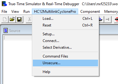

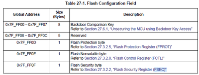

Page FF covers global 0x7F_C000 – 0x7F_FFFF address range that includes the Flash configuration filed and the Flash Security byte.
I assume the MCU is secure, please try the Unsecure command.

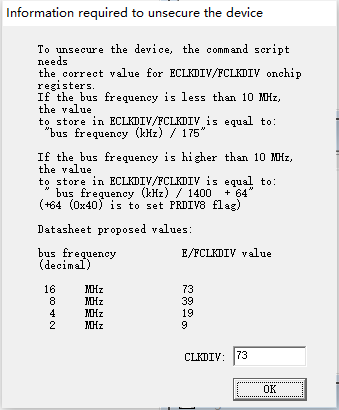

Unsecure is failure as follow:
Using default configuration: (Bus clk maybe 40MHz)

Can you take a look at the project and read what was written to the ECLKDIV / FCLKDIV registers?
What is the frequency of the oscillator?
BR, Daniel
3,696件の閲覧回数
qinxk
ECLKDIV/FCLKDIV = 0x28
OSCCLK = 8MHz

Have you tried with CLKDIV = 0x28 = 40?
BR, Daniel
3,669件の閲覧回数
qinxk
Hi, yes
It is still failure!
