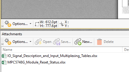

zhangcope
Hi,Where can I find the EXECL file?
1,559 Views
PetrS
in your PDF viewer show the Attachment pane
BR, Petr
