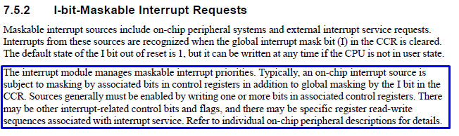

Hi All,
While studying The interrupt module in Datasheet of MC9S12XEP100 family
I had This Doubt " How Interrupt control module decides which interrupt has occured? when Interrupt happens."
For Example
" If Timer Interrupt occurs How INIT module find this Interrupt was caused by Timer Module ?"
Data Sheet: https://www.nxp.com/docs/en/data-sheet/MC9S12XEP100RMV1.pdf
Thanks in Advance :smileyhappy:
Haricharan

You can refer to the reference manual of the core:
CPU12/CPU12X - Reference Manual
But the description is rather generic:
Basically, the interrupts must be locally enabled and their interrupt flags must be set to be recognized as pending.
In such a situation when an interrupt triggers but its flag is cleared before its vector is fetched and there is no other interrupt pending, the spurious vector is fetched instead.
