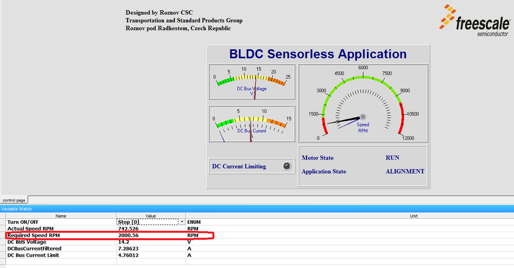

Can I modify the code to change the motor speed?
what is the code to control the speed of the motor ? And how to modify the code can control the motor speed?

as far as I know this motor control application can be controled from FreeMASTER visualization tool via OSBDM serial COM. (see the screenshot below)
FreeMASTER .pmp file should be part of the demo application.
Hope it helps.
