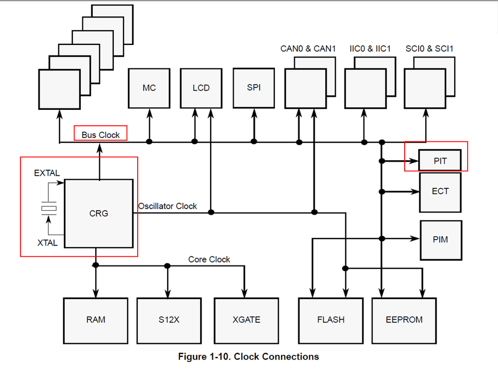

Can someone tell me how can I calculate time required by timer to increment by 1, if I am using 16MHz crystal with noprescale in MC9S12XHZ512 .

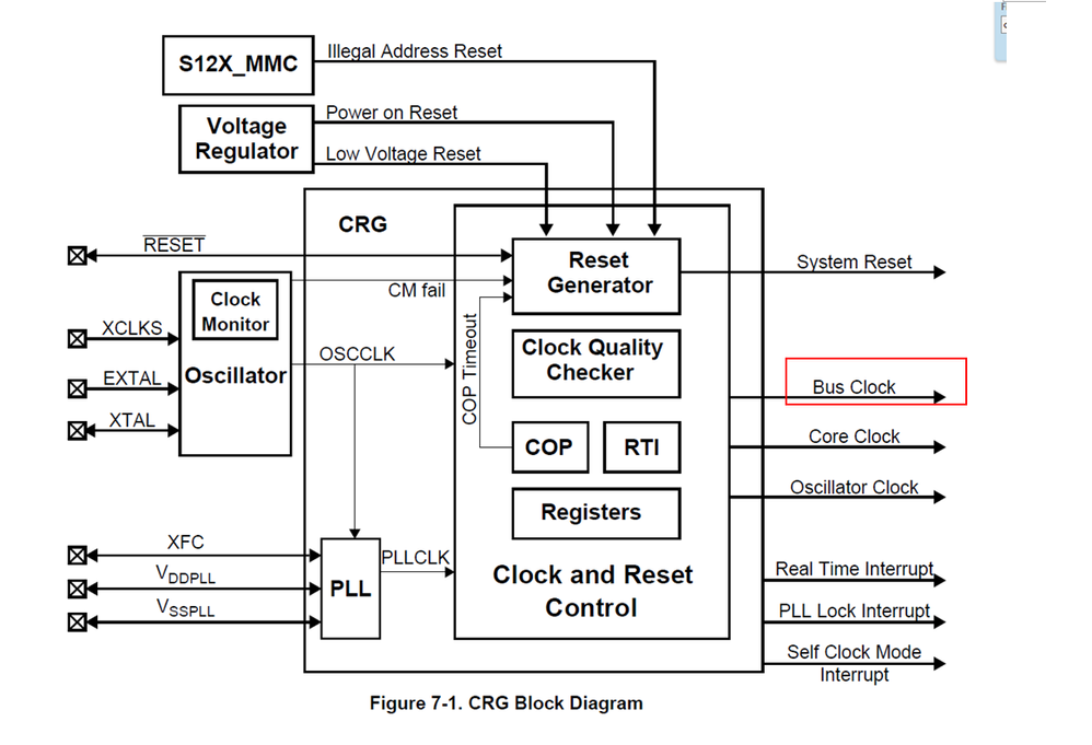

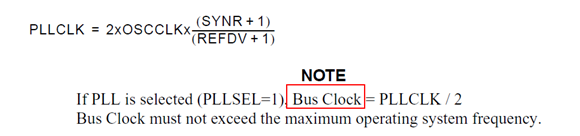

Hi KDN,
As for the timer block use the bus clock (according the related registers ),firstly you need calculate the bus clock , then you can get the time of timer increment 1.
Below is the mainly calculate process ( MC9S12XHZ512):
You can according your configuration of register and the calculate procedure , get the result.
If you still  have  any question,  welcome to the community discuss.

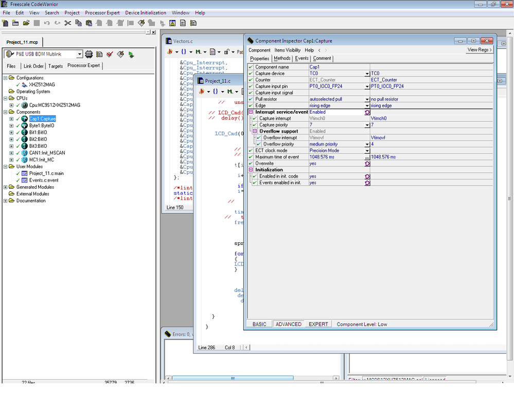

What actually I want to do , I am using Input capture mode of MC9S12XHZ512 for calculating frequency and duty cycle of square wave from 1KHz to 10KHz , I have attached image of setting i have done in codewarrior.
My problem is that when I try to display frequency on my LCD display I am getting random charter on , I also have problem with interrupt input capture mode I have enable input capture mode in codewarrior , but i'm not able to find it in program , I want to write my display and calculation code in interrupt sub routine of input capture mode. I have posted my code below.
I'm using 16MHz crystal

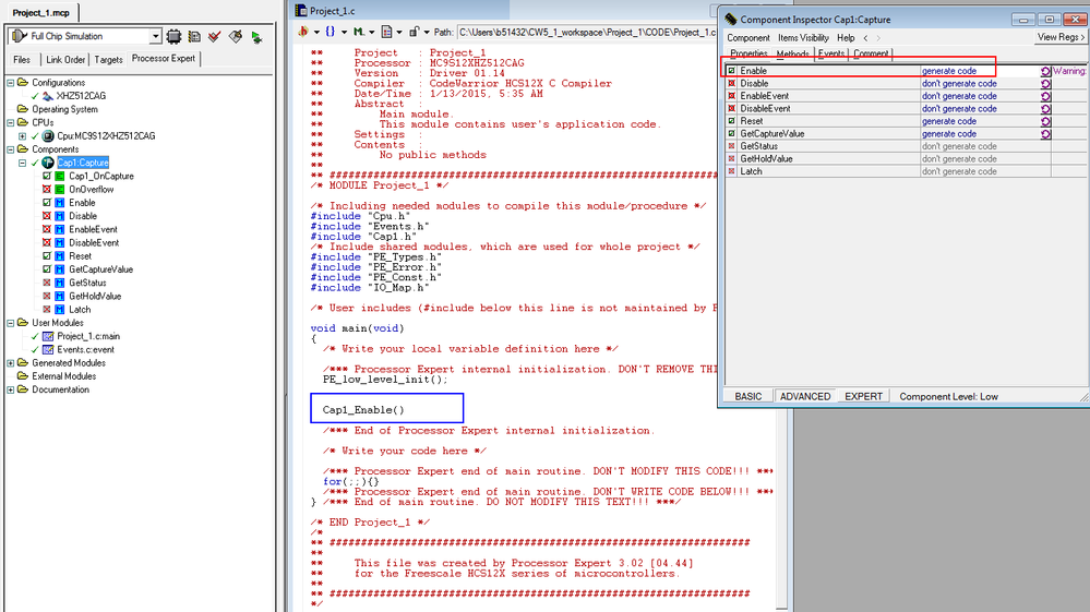

Hi KDN,
In your code , you should enable the capture component and interrupt like this :
Then you test whether it can enter the interrupt .
Alice

kdn
Thanks for replay , I done that ,
Now my problem is this calculation .

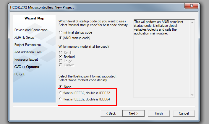

Hi KDN,
When you want use float data, when you create project , please choose like this :
Hope it helps
Alice

kdn
Thanks I Have selected float IEEE32 and double IEEE32
But not working
