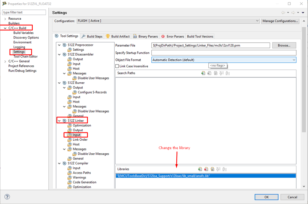

hi!
   I use code warrior10.7 to built a new project,but forget setting floating point options ,Can it be added in the future?
  S912ZVM
902 Views
dianabatrlova
Hi Max,
You can enable floating-point by right click on your project -> Properties and after that select appropriate librarypastedImage_1.png
This question was already discussed in the community, for example, in the link below. I recommend you to read a Note where are described ANSI libraries, it helps you to select the right one.
https://community.nxp.com/message/849209?commentID=849209#comment-849209
Diana
