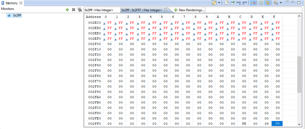

an example of prm file. See modifications in bold.

Result of the modifications is.....RAM 0x2e00~0x2eff is not used by application for variables and it is filled by patter 0xff at the start of the code automatically. RAM 0x2f00~0x2fff is used for STACK.
Ladislav
