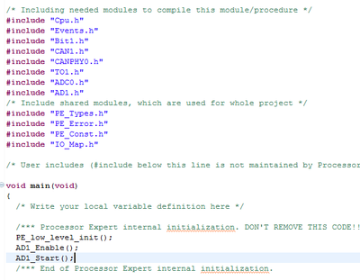

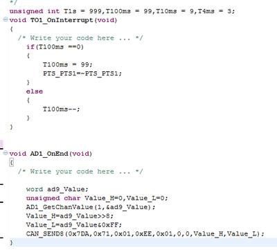

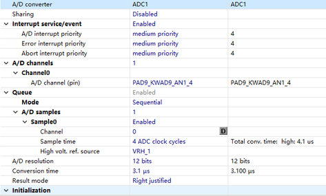

I use for developement an MC912ZVMC256 board and I want to ADC triggered by Output Compare.
I set it up as below.
 I have connected the PT0_IOC0  pin to the PAD9 pin,and I can get the ad value of PAD9 pin in the AD1_OnEnd() function.But it is not triggered by Output Compare.How can I modify it to achieve this function.

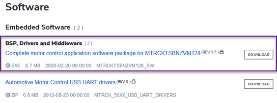

You can refer to:
MTRCKTSBNZVM128: 3-phase Sensorless BLDC Development Kit with S12 MagniV S12ZVM
https://www.nxp.com/design/development-boards/automotive-motor-control-solutions/magniv-and-s12-solu...
AN4704 3-phase Sensorless BLDC Motor Control Kit with the S12 MagniV MC9S12ZVM
https://www.nxp.com/docs/en/application-note/AN4704.pdf
