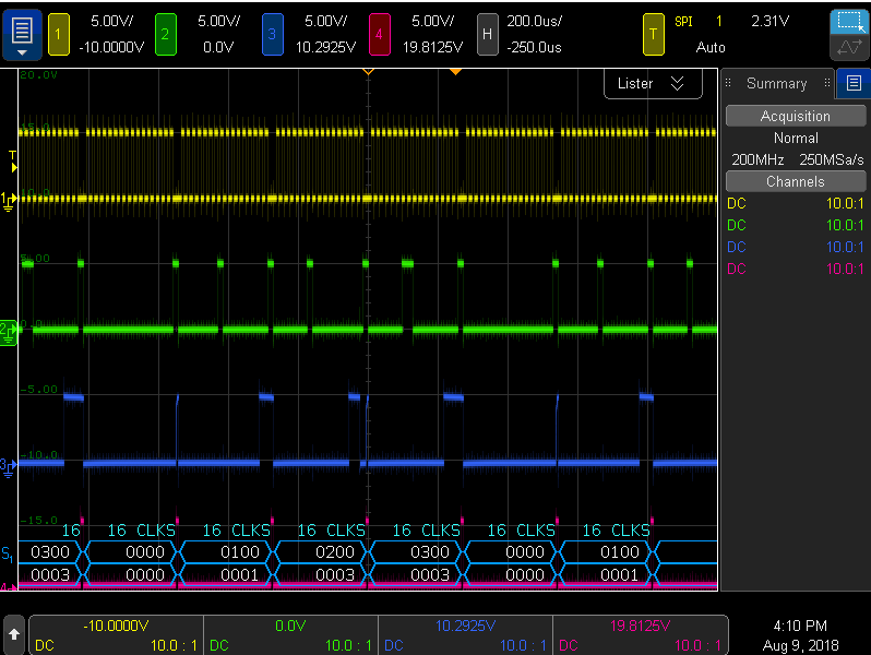

I am trying to read of the registers in the MC33937 after a reset. The communication  looks good, but the values that are returned from the MC33937 are not what I am expecting. Here is a scope shot of the communication:
According to the datasheet for the MC33937 I would expect after a reset:
register      1)         2)      3)         4)
expected   0x80   0x00   0xFF   0x00
getting       0x00   0x01   0x03   0x03
This is how I setup the SPI for the S12ZVMC in CW 11:

Hello John,
Please try to change the SPI0CR1_CPHA bit to 1. The MC33937 uses the ‘Mode 1′ SPI protocol, which means that an inactive state of clock signal is low (CPOL = 0) and data are captured on the falling edge of clock signal and changed on the rising edge (CPHA = 1).
Also please double check that the timing is in accordance with the following specs:
I hope it helps.

Hello Thomas,
Yes, I set for mode 0. I have misunderstood the timing diagramm and believed it was for mode "0" instead of mode "1" as you mentioned. Your explanation helped a lot. Thanks for that. As I am on holiday, I can first confirm when I am back, but I had to talk a look.
