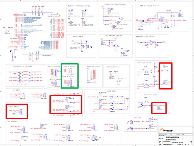

System settings
Considering S12ZVM PMSM/BLDC development kit as an example, jumper settings should be changed to have the PWM signals clear (with no external load or source, e.g. pull-ups).
Jumper Default settings Configuration for the test Notes
J9 Enabled Disabled User On/Off switch on PT1
J14 2-3 Removed EVDD / Fault input on PP0
J15 2-3 Removed HALL_A / Res_A on PT1
J16 2-3 Removed HALL_B / Res_B on PT2
J19 Enabled Disabled "Up" button on PP1
J20 Enabled Disabled "Down" button on PP2

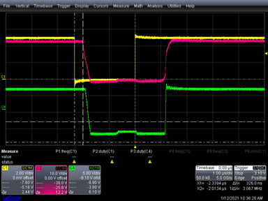

Oscilloscope of sufficient parameters should be used (at least 500Ms/s) with standard low-capacitance probes or better, with isolated differential probes. Channel connection for the test should be as follows:
  • Channel 1: PWM1_n signal to GND (for PWM1_0, PP0 on J21:1 can be used)
  • Channel 2: GDU HGm or LGm signal to GND (for HG0, TP31 is used) or HGm to PHASE_m if differential probe is used (for HG0, TP31 and PHASE_A / TP35)
  • Channel 3: Phase voltage on PHASE_m to GND (e.g. PHASE_A)

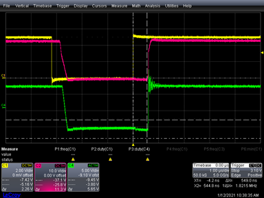

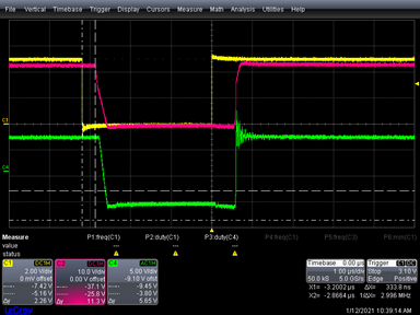

Resulting waveforms can be seen on the following figures for normal (room) conditions and using following setup:
Item Details
Oscilloscope Lecroy WaveRunner 44Xi-A
Probes PP008 / 500MHz, 10MΩ, 9.5pF
Evaluated PWM signal PWM1_0 / HG0
EVB
S12ZVMLEVBLIN Rev.D
Two corner cases have been used to match the specifications in the Reference Manual. However, user-specific slew rate settings may be used to measure the delay in the application.

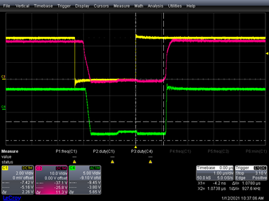

Slowest Slew Rate Settings (GDUsrc=0)
Switch-on delay:
Switch-off delay:
Fastest Slew Rate Settings (GDUsrc=0x77)
Switch-on delay:
Switch-off delay:

Measured values are compared with the Reference Manual specifications. Switch-on and switch-off delays are presented. As seen below, the results are within the specified range.
Slew rate Edge Minimum Maximum Measured
Fastest slew T_delay_ON 0.47 μs 0.89 μs 0.55 μs
T_delay_OFF 0.25 μs 0.49 μs 0.32 μs
Slowest slew T_delay_ON 0.77 μs 1.43 μs 1.08 μs
T_delay_OFF 0.25 μs 0.49 μs 0.33 μs
