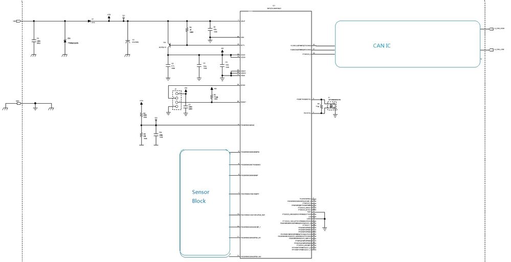

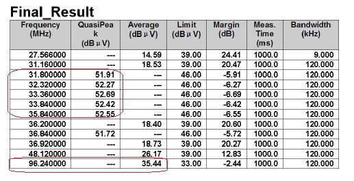

Dear NXP Enginner:
     In our project, the NXP MCU S912ZVLA64F0MLF is used;
     At present stage, the EMC CE test failed,as below, the failure frequencies are  between the range of  31.8~35.8Mhz, and 96.2Mhz point;
We checked our design(circuit&programm) carefully, while no source of upper frequency points  were found.There are just MCU,SENSOR and CAN phy ,sensor and can phy just work in 500~900Khz frequence.schematic as below:
One doubt way is:
The DC regulator is internally intergated in the MCU (S912ZVLA64F0MLF) ;
Wheather  the upper relate  frequency are generated from the internal Regulator Block?
Besides,any other possible source of the relate  frequency?
It is urgent ,Could you help me ?thanks!

danielmartynek
I don't think this is caused by the regulator if you use the recommended decoupling capacitors.
Speaking of the regulator, if you use the external ballast transistor, the internal one must be disabled.
CPMUVREGCTL_INTXON = 0.
Have you tried changing the PLL/BUS clock frequency?
What is the frequency of the crystal?
Do you use the oscillator in Loop Controlled Mode or in Full-swing Mode?
The Full-swing mode offer higher immunity against noise injection on the cost of increased emission.
Please refer to AN5084 Hardware Design Guidelines for the S12ZVL Microcontrollers
3 Power management
5.2 Suggestions for the PCB layout of oscillator circuit
13 General Board Layout Guidelines
13.3 EMI/EMC and ESD Considerations for Layout
