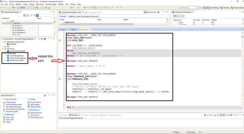

Hi Dashuang,
I was facing the same issue but I found one solution.
LIN Stack Problem with Processor Expert Mode here I added my one sample code and needed changes in the screenshot.
Notes:
1. If you are using baud rate other than 9600 then enable autobaud support and add Vtim0ch3 interrupt.
2. Add autobaud lib files from \bsp\AUTOBAUD folder.
3. In Vtim0ch3 ISR add AutobaudTimerValEval(); like
Mark helpful if it helps you.

dashuangshengds
Hi Chaitanya
      Thank  you help! I also find another soluton:  In vector.c file, I add "extern void SCI0_INT(void); extern TIMchan2_ISR", and modify vector define for SCI0 and timer channle 2.
