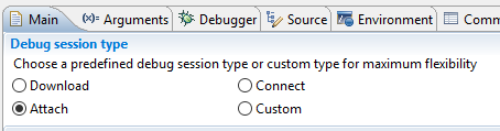

Attach the debugger,
clear the 'i' variable to 0 in the Variable view,
step the code and check all the flags.
