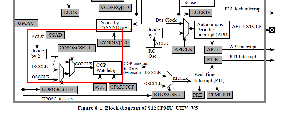

Dear Team,
I want to know the default value of ACLK clock available in S12ZVL controller .
It is good to have if I get example of watchdog timer for S12zvl controller.

Nominal value of ACLK is 20kHz.
ACLK frequency is divided by 2 when ACLK is selected as clock source for watchdog:
So, 10kHz is source clock frequency for COP watchdog.
Minimum timeout (CPMUCOP_CR=0x01, CPMUCLKS _COPOSCSEL1=1) is 2^7*(1/10kHz)=12,8ms
Maximum timeout (CPMUCOP_CR=0x07, CPMUCLKS _COPOSCSEL1=1) is 2^17*(1/10kHz)= 13,1072s
Note: ACLK frequency could be trimmed by modifying CPMUACLKTR register value. Note: After reset a value is automatically loaded again from the Flash memory.

Dear RadekS,
Thanks for answer. The value of ACLK is not mention in S12zvl datasheet .
May I know how you got  ACLK value.

This information is directly from MC9S12ZVL Family Reference Manual Rev. 1.04
Please look at chapter A.2.1 VREG Electrical Specifications (page 685), parameter 7,
Trimmed ACLK output frequency, typical value fACLK=20kHz.
