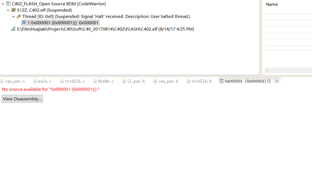

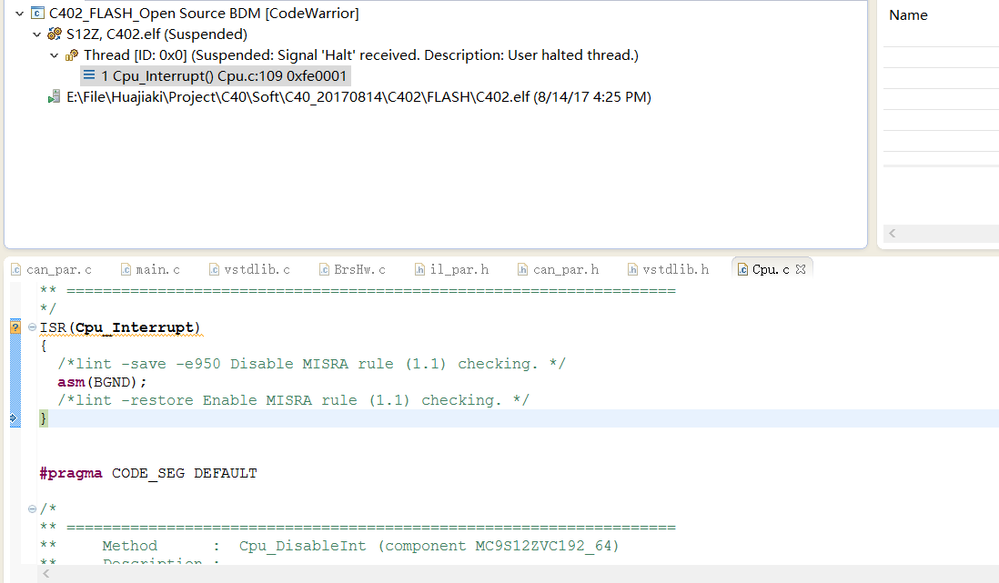

But at the time of debugging problems:
I hope you can help me again,Thank you very much!

my guess would be that those are problems caused by stack over-/underflow.
On S12Z an interrupt stack-frame is 29 bytes (compared to 9 bytes on S12G). This must be taken into account when defining the stack-size.
Also, with-out knowing what interrupt vector "Cpu_Interrupt()" is actually serving, please be aware that compared to S12 there is a new exception type called "machine exception" on S12Z. This is mapped to a single interrupt vector (please refer to the interrupt table in the RM).
A machine exception is a non-maskable hardware interrupt, meant to flag severe system errors, with the special property that no interrupt stack-frame is written. And, since there is no context information present on the stack, this means the machine-exception service routine cannot be left with a simple "RTI" instruction.
