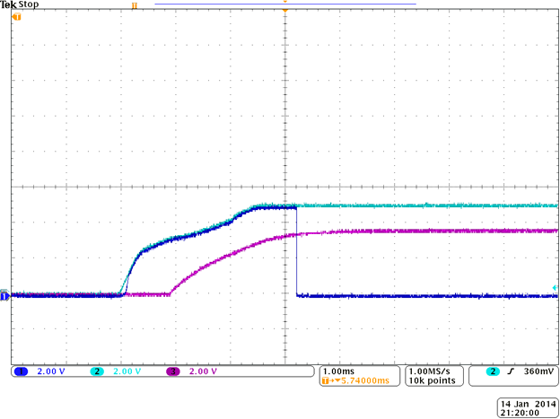

There are two types of reset - Power on and internal reset. The pictures are different device but the principle is the same. They are used only to better understand.
1) For power on reset; the value at the pin with pull up appears immediately after CMOS logic reaches its operating votage (app. 0.9V) from this moment the voltage at the pin is the same as an rising source voltage used for pin pull up device.
Measurement performed at the pin with pull up connected to the pin (in the data sheet it is presented as a pull up connected after reset)
Trigger is Vdd voltage
Procedure is: transformer plugged in mechanically, when I tried to use switch there were glitches - this power on is much better for image)
Blue: voltage at the pin with pull up defined after reset (log.0 written to the port after reset at 5.2ms)
Cyan: Vdd
Violet: reset pin voltage

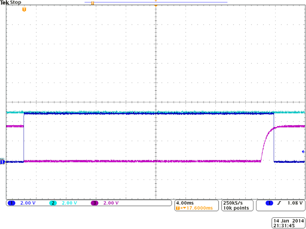

2) For internal reset; the changes are performed immediately
connected after reset) - the same as previous case
Trigger is falling edge at the reset pin - I have pressed the reset button
Vdd is constant
Blue: voltage at the pin with pull up defined after reset (log.0 written to the port after reset by SW)
Cyan: Vdd
Once more, these pictures are measured at different device. Not S12ZVC.
