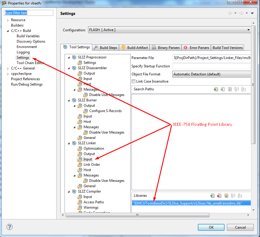

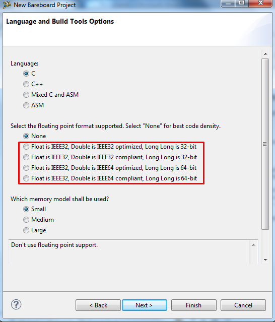

I can't compile through,in the  line as follow:
       //We could calculate measured voltage with fix reference voltage 5V
       pot = (pot_raw * (float) REFERENCE_VOLTAGE)/4095;
can you tell me while,TKS.
Hi Shen,
This line use re-type to float. I suppose that this may be a root cause.
If you want to use float type, you have to use float library.
You may create new project with float support
or, you may edit project settings and replace standard C no float library ansii.lib by for example C float library ansif.lib
1. Float is IEEE32, Double is IEEE32 optimized, Long Long is 32-bit
ANSI library: ansif.lib
Compiler options:
2. Float is IEEE32, Double is IEEE32 compliant, Long Long is 32-bit
ANSI library: ansifc.lib
Compiler options: -fp_compliant
3. Float is IEEE32, Double is IEEE64 optimized, Long Long is 64-bit
ANSI library: ansidm.lib
Compiler options: -double_size=8 -bit64_code_gen mem
4. Float is IEEE32, Double is IEEE64 compliant, Long Long is 64-bit
ANSI library: ansidmc.lib
Compiler options: -fp_compliant -double_size=8 -bit64_code_gen mem
I hope it helps you.
