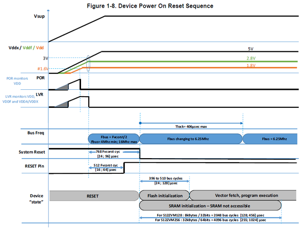

You can refer to the Power On Reset Sequence in the S12ZVM RM, it is the same for S12ZVC.
https://www.nxp.com/products/processors-and-microcontrollers/additional-mpu-mcus-architectures/s12-m...
Can you scope VDD, VDDF, VDDA, VDDX along with the reset pin?
Is the reset pin disconnected from any other circuit on the board?

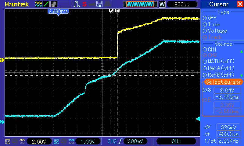

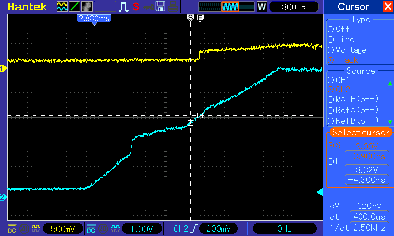

     The S12Z has been covered by thermal compounds which is not able to be removed. Thus, I am not able to scope the VDDA VSUP pin. Fortunately, VDDX pin, connected to the external PNP, can be scope along with the reset pin. In the following graphs, the yellow signal is 'reset' and the blue signal is 'VDDX'. The normally working one is list first followed by the faulted one.
fig 1fig 1
fig 2fig 2
It shows that a sharp raising edge was missing in the faulted case although the tendency was similiar . There is a 10pF capacitor on the reset pin on both controller.

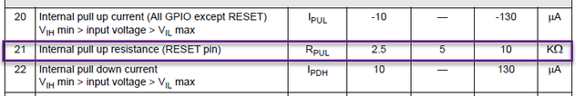

In fig 2, we can see that the MCU releases the reset pin when VDDX reaches the LVR threshold voltage.
S12ZVC RM rev.2.1, Table E-1.
If it is not driven externally, the reset pin is then pulled to VDDX by the internal pull-up resistor.
Table A-8.

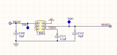

What is connected to the reset pin besides the capacitor that you mentioned?
Can you disconnect everything including the debugger?
Thank you,

    In theory, nothing is connected to the reset pin except for the capacitor mentioned.
    fig 1fig 1
    So,  whether can it be said that it may be a problem related to the manufacturing process, such as bad soldering, external component damage, rather than a chip problem?
