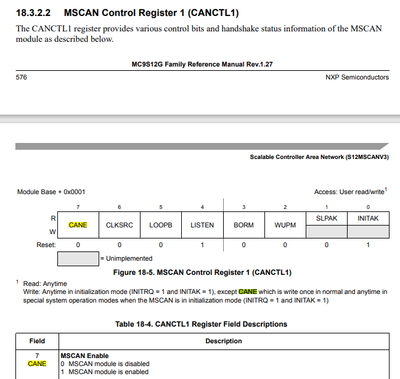

S9S12G64F1MLC Mask 1N75C For this part, in customer’s application, CANE of the CANCTL1 set to 0, customer want disable MASCAN mode. When the debug the project step by step, read register CANE is 0, but when project run, the find the CANE changed to 1. But they don’t use CAN module in the project.
