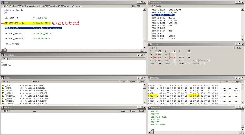

The SPI MOSI pin defaults to high. So when no data is being sent, it goes high. I would like it to be low.
So I had a look at the Port Integration section of the Reference Manual, and it seemed this should be possible. The settings would be: wire-or mode, pull enabled, pulldown i.e. for MOSI on port 0:
WOMS &= ~0b00100000;  // set PS5 to wire-or mode
PERS  |= 0b00100000; // enable pull resistor on PS5
PPSS |= 0b0010000; // pull down
I'm afraid this doesn't work. I assume that is because these configuration bits do not apply when using the pins as SPI.
Or have I made an error?
Any other way to make the default state of MOSI low?

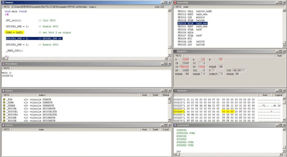

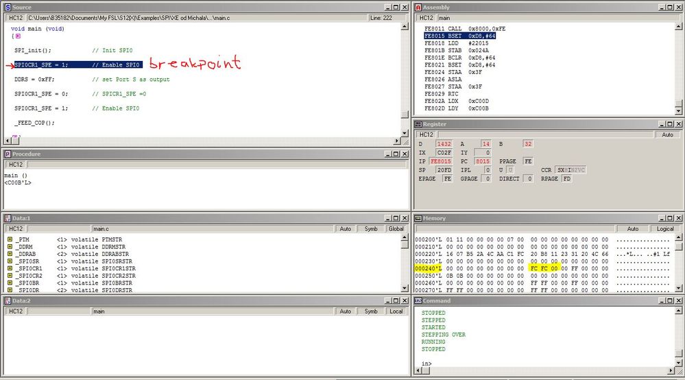

David is right. You must disable the SPI. Also you should set the Port Data Direction Register (DDRS for example) as output. I've tested this on DEMOAX9S12XEP100 board. See screenshots below (click on them to enlarge):
1. Initial state. SPI module initialized, but not enabled yet. The yellow marked address in memory window shows Port S Data Register (PTS) at 0x0248, Port S Input Register (PTIS) at 0x0249 and Port S Data Direction Register (DDRS) at 0x024A address.
As you can see Port S is set as input and PTIS reflects the buffered state on the pin which is 0xFC (taken from the PTS register). The MOSI pin (PS5) is logic 1.
2. SPI enabled. Port S dedicated to SPI module.
3. Port S set as output. SPI still enabled. the PTIS reflect the 4 SPI pin status: MOSI and MISO are high.
4. SPI disabled. Finally, PS5 (MOSI) pin is low as well as other Port S pins.

In SPICR1 after your SPI session is complete, set SPE to 0. This will take SPI off the buss and allow IO control over the pin.
