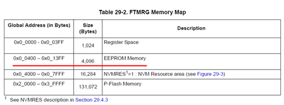

For table describing this please look at chapter 24.4.5 Allowed Simultaneous P-Flash and EEPROM Operations in the data sheet.

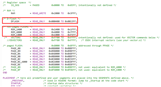

jeffcharles
Hi Ladislav,
Thank you for your reply.
I want to operate the EEPROM whose global address ranges from 0x0_0400 to 0x0_13FF. Is it real EEPROM or simulated with FLASH? It is called DFLASH in the prm file in CW5.2. My application codes are stored in the non-paged FLASH and paged FLASH, so I am worried about whether the interrupt servie functions will disturb the operation of EEPROM.
