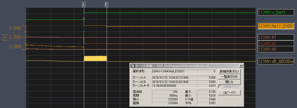

pratibhasurabhi
Contributor V
Hi Danial,
In our application, there is no other functionality enabled on PTP0.
I have tested code as below,
main()
MODRR2_T0IC1RR = 0x01;               /* TIM0 input capture channel 1 is connected to logic XOR of PT1, PT2, PT3 */
PERT = 0x0E;                                      /* Hall sensor PT1, PT2, PT3 pull device is enabled */
PTP_PTP0 = 1;
DDRP_DDRP0 = 1;
while(1)
   /* after 500ms of delay below code is executed */
ADC0CTL_0_ADC_SR = 1;
PTP_PTP0 = 0;
CPMUOSC_OSCE = 0;
DisableInterrupts;
 ASMNOP;
ASMNOP;
ASMNOP;
ASMNOP;
asm ANDCC #0x7F;             /* Clears S bit , enable STOP instruction */
ASMNOP;
ASMNOP;
asm STOP;
After executing this code, observed that, after 500ms of power up, EVDD1 pin output is high(4.8V) after entering into stop mode. As shown in below screenshot,
Even after setting PTP0 pin to low the output at EVDD1 is high.
As per my understanding, hall supply will not get disabled for above setting.

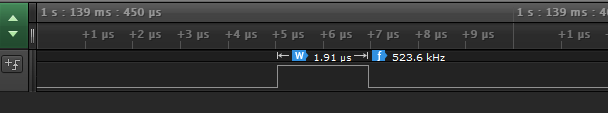

danielmartynek
Hello Pratibha,
I have tried the very code you provided without any modification on S12ZVML12 EVB and it works as expected.
The PP0 pin goes HIGH for 2us then LOW and the MCU enter Stop mode.
Have you tried running this simple code on an EVB?

danielmartynek
Hello Pratibha,
EVDD1 is supplied by VDDX (Table 1-8, S12ZVM RM r.2.11).
The VDDX regulator enters Reduced Performance Mode (RPM) when the MCU goes to Stop Mode (Section 8.1.3.3)
The load IDDX current in RPM is specified in Table B-1.
“In stop mode the over-current monitor is disabled for power saving. The increased current capability cannot be maintained to supply the external device. Therefore when using the pin as power supply the external load must be powered down prior to entering stop mode by driving the output low” (Section 2.5.3).
4,392 Views

danielmartynek
Hello Pratibha,
The EVDD1 funtion of the PTP0 is basically a GPIO with high current capability.
Configuring the pin direction as output automatically enables the EVDD1 funtion.
DDRP_DDRP0 = 1; // OUTPUT
It can be driven by the PTP register as any other GPIO. And the PORT maintains its previously configured state during Stop mode.
PTP_PTP0 = 0; // LOW
Unless there is another function with a higher priority enabled on PTP0.
Have you tested it with a simple code that just drives PTP0 and enters Stop mode?
