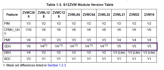

There is a feature that prevents that.
GDUv4 does not have this SR mode that allows that.
But you can test it on GPIOs.
