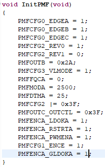

We have referred the MC9S12ZVML128 hall sample code for our application development.
We have done the PMF setting as below,
In SW, we have cleared the GDU flag and handled the PMF fault on GDU level(i.e. GDU over curent, VLS under voltge, HD over voltage failsafe are implemented) and its respective GDU flags are cleared.
As per the datasheet, clearing of PMF fault is must.
Request you to confirm that, is it ok if we clear the GDU flags and not clearing PMF fault using PMF register?

Hello pratibhasurabhi,
If the PMF fault detection is enabled (PMFFEN) you can use either Automatic or Manual PMF Fault Recovery.
Please have a look at these sections in the RM.
15.4.13 Fault Protection
15.4.13.2 Automatic Fault Recovery
15.4.13.3 Manual Fault Recovery
