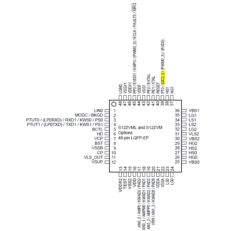

I want to know the number of timer zero channels in ZVM16(48 pin) MCU.
In Pin out diagram of ZVM16(48 pin) MCU only one channel is shown as below in yellow mark,
I want to confirm, is there only one channel of timer zero or other channels are there?
Its urgent,please inform me the answer of same as early as possible.

Hi Pratibha,
It seems that you probably have some older version of reference manual.
The current version 2.11 shows also routing option for IOC0_1 and IOC0_2 at pins PS0 and PS1.
I hope it helps you.
