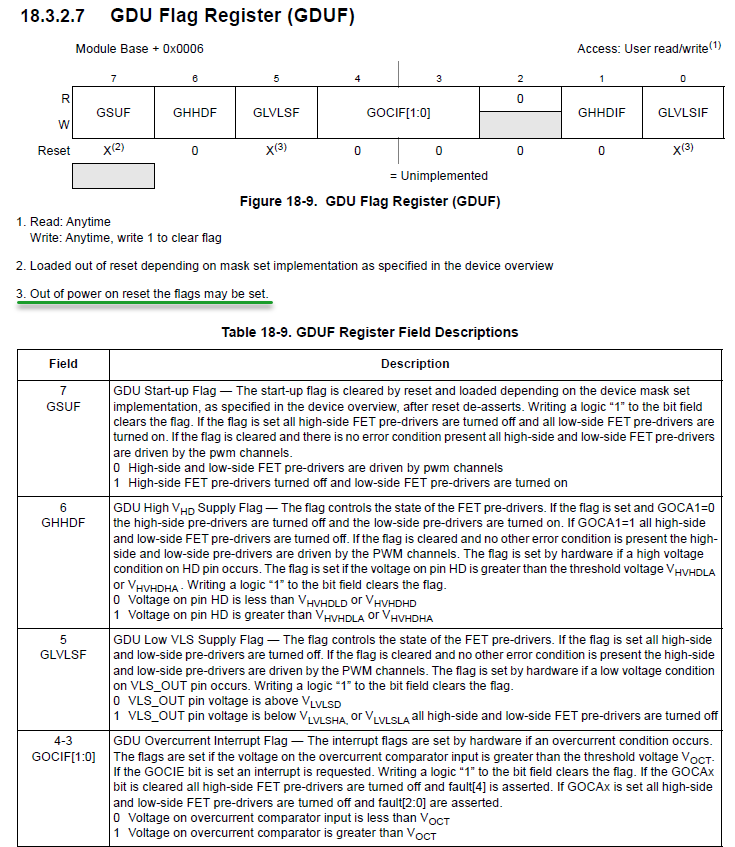

1. Since the maskset is 3N95G, low side gate should be turned on, since at power up GSUF will be loaded with value in FOPT register. [GSUF bit will have value as 1] [Reference GDUF register description]
2. Also LGx will be turned off when initPMF() is executed, since the PWM are masked (PMFCFG2 = 0x3F).
So all things considered [ above two points], LGx should be turned on at power-up[FOPT value loaded] and will be turned off when initPMF is executed[mask PWM].

Anyway, the debugger is not powered and it is an additional load on the reset pin, so the reset voltage is rising slowly which gives some time for the VLS_OUT output to stabilize before the MCU leaves reset (reset pin voltage > 0.65 * VDDX). And this means that the GLVLSF flag is not set, and the LS driver are active.
Whereas without the debugger, the reset pin read HIGH immediately probably before the VLS_OUT output is above the low-voltage threshold and this sets the GLVLSF flag.
When the GLVLSF flag is set, the LS drivers are inactive.
As you pointed out, the demo SW clear the flag in the initCPMU() function.
However, this is the code:
// Wait for stable supply after power up
while (GDUF_GLVLSF)
GDUF_GLVLSF = 1;‍‍‍

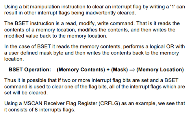

The GSUF flag is set in your application (copied from NVM during reset) along with the GLVLSF flag.
The code above does a read-modify-write operation on the register and therefore it clears the GLVLSF flag along with the GSUF flag. Because both the flags are w1c.
Therefore, once the GLVLSF flag gets cleared, the GSUF flag = 0 as well and the LS drivers stay inactive.
Could you please use this code instead:
while (GDUF_GLVLSF)
GDUF = 0x20; // mask GLVLSF only‍‍‍‍‍‍

Regarding "The code above does a read-modify-write operation on the register and therefore it clears the GLVLSF flag along with the GSUF flag. Because both the flags are w1c."
My understanding was since we were accessing a specific bit, it wont affect the other bits/entire register.
Is this specific for w1c registers or is there a specific list. If possible can you please share the document or the link to it?
Thank you
4,647 Views
danielmartynek
Hi pratibhasurabhi,
Please have a look at AN2554/D Clearing and Disabling Interrupt Flags
while (GDUF_GLVLSF)
GDUF_GLVLSF = 1;
while (GDUF_GLVLSF)
