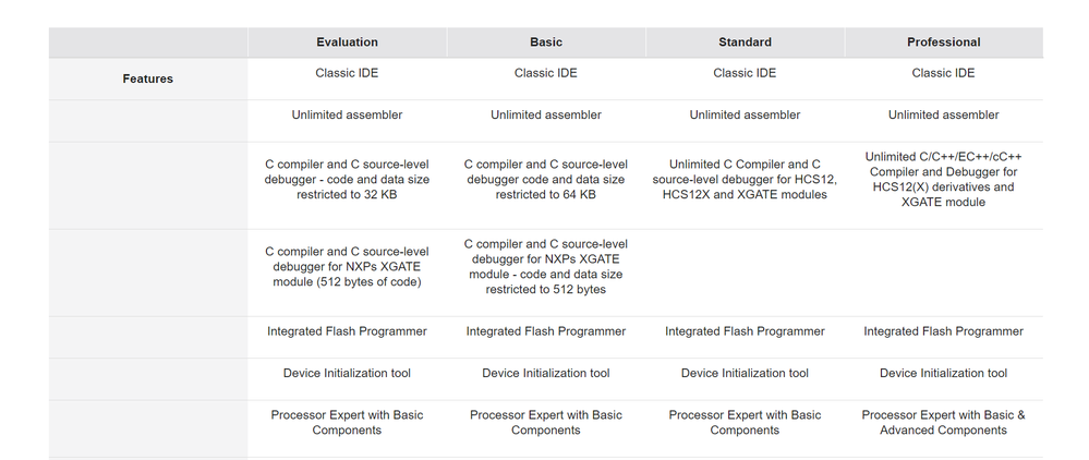

sourabhjain
Which IDE categories should i used in attached snapshot ?

dianabatrlova
The CodeWarrior Evaluation license (based on the Professional Suite) is time-limited usually 30 - 45 days.
After that, it is a Special Edition (Free Tool).
The restriction only lies in the software feature. So, it is up to you if the special edition fill your requirements or you buy the CW license (Basic/Standard/Professional)
Also, you can look at the details on the link below:
https://www.nxp.com/docs/en/fact-sheet/950-00437.pdf
I hope it helps.
Diana
