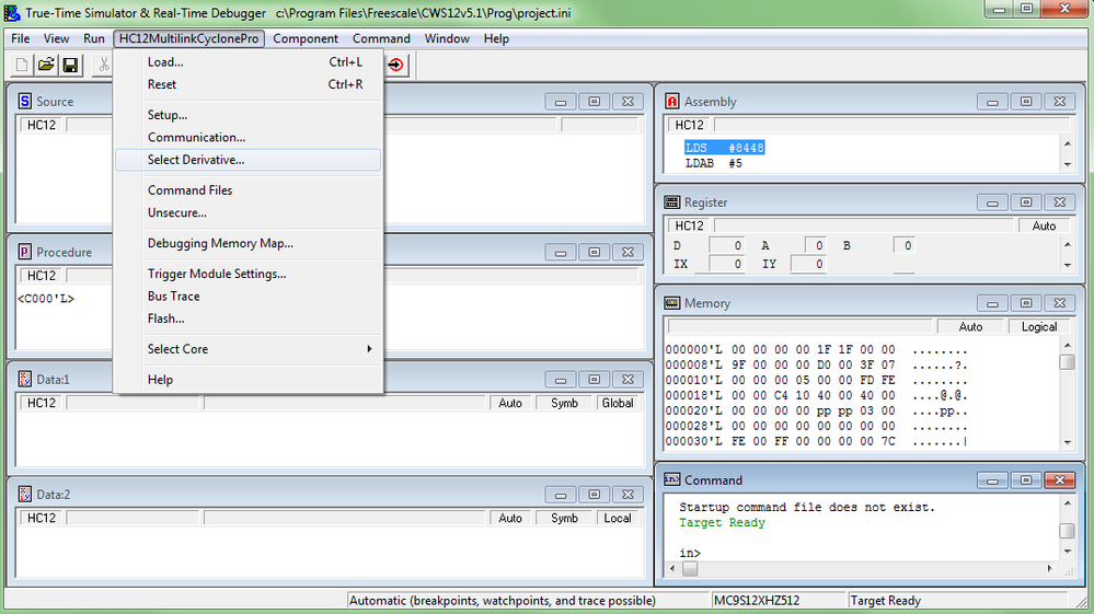

  1. Connect USB Multilink and power to MCU
  2. Start debugger (HiWave). Example path: "c:\Program Files\Freescale\CWS12v5.1\Prog\hiwave.exe"

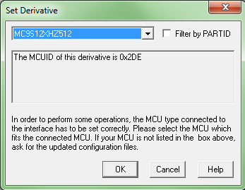

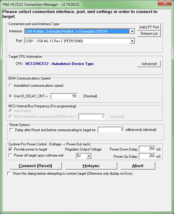

  3. In menu-Select Derivative choose your MCU, for example MC9S12XEP100DUMP1.PNGDUMP2.PNG
  4. Optionally you have to set also USB Multilink in Connection Manager window (menu-Communication)

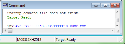

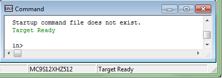

  5. MCU should be now connected and you can read “Target Ready” in Command window

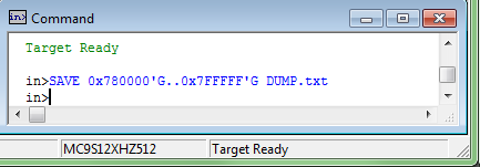

  6. Enter command “SAVE 0x700000'G..0x7FFFFF'G DUMP.txt” into Command window and press Enter
  7. Now you should wait some time (depends on MCU clock and BDM speed)

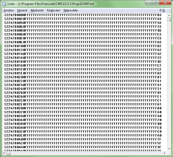

  8. File DUMP.txt you can find in the same directory as debugger. Example path: "c:\Program Files\Freescale\CWS12v5.1\Prog\DUMP.txt"
