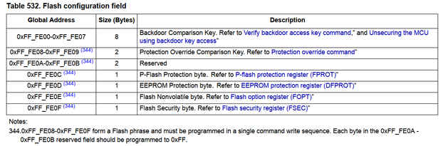

Write_Mem(SoByte, FCCOB0Lo, AddrHi)    // SoByte= 0x10, FCCOB0Lo(0x38D), 2nd byte of the address to be written AddrHi =(address & 0x00FF0000)>>16) = 0xFF  …. Se table flash configuration field bellow
Wait(16 or 32); //based on protocol
Write_Mem(soWord, FCCOB1, AddrLo)    // Word= 0x14, FCCOB1(0x38E), low word of the address to be written AddrLo= (address & 0x0000FFFF) = 0xFE08;
// write flas security field data0=0xFFFF, data1=0xFFFF, data2=0xFFFF, data3=0xFFFE (unsecure the MCU after next reset)
// if you do not unsecure it then after next reset it will be secured again

//now the device is prepared for loading entire memory except security “phrase” and its sector which should be erased individually and rewritten to the required value based on S19 record.
// of course you procedure can be different but is is up to your ideas and design.
