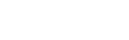

    I there was a problem in the application MC9S12XET256 chip:When the CPU has frequently CAN interrupt and a serial port interrupt occurs, the program will occasionally in crash situation.When back to normal after close the COP, is there a better handle this suggestion?
    And why the program crashes, does not automatically produce watchdog reset? whether you need to do in watchdog interrupt processing can trigger watchdog reset

    After debugging found out the problem:Program to jump to the watchdog interrupt, and did not back out of the interruption, and does not cause watchdog reset.
    But,When inside the watchdog interrupt execution JMP statements(asm{jmp $C000;};) , program can trigger watchdog reset properly;If you do not execute the statement,Will not trigger watchdog reset,And the program crashes(code run away), all not output pin.What's the problem?

jinchengxie
Add the instructions above:The main and the PRM file inside the key code as shown.

jinchengxie
Hi Radek,
When adding notes, not careful comments of the code.I'm sure the “for” loops is long enough,And the program has jumped to the CopInterrupt(),And all the pins have no output.as shown in the figure,Why is the difference between two things?

RadekS
Hi XJC,
It hard to say what exactly happened in this extreme situation. Theoretically, it might be debugged on assembler level.
It is like a jump from the window. Sometimes you may fall on your legs, sometimes on your head. It might depend left or right leg used for the jump start. And always it depends on floor level from which you jumped.
Since, the CopInterrupt() is not ended properly by asm JMP command, the RTI will restore some data from the stack. I suppose that the difference will be just in stack content or stack pointer during MCU reset.
The Situation 2 is a just happy coincidence where RTI instruction will fill program counter by some valid data.
I suppose that i and j variables are probably not static and they exist on the stack. This may cause different stack pointer value and the program counter is filed by invalid data after the watchdog reset.
Anyway, it is code runaway in both situations with happy end only in one case.
