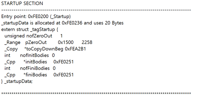

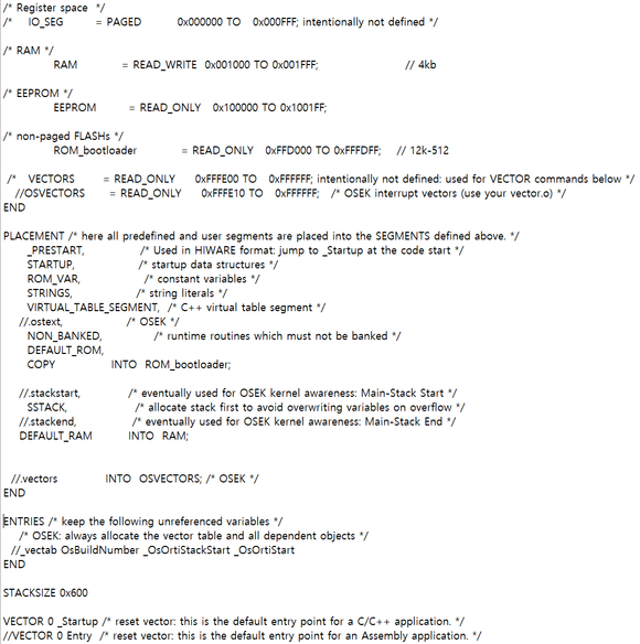

I make bootloader with 128kbytes s12z.
I can see 'go to app(0xFE0200)' function is performed, but application does not worked.
It seems like software reset due to watchdog.
I attached my configuration of prm and map file.
Please give me your suggestion.
<<startup section at map file>>
<<prm file for Application>>
<<prm file for Bootloader>>

There could be various reasons. Just debug it. If you didn't know, you may temporarily/permanently add bootloader code to your app binary with this line in your app prm file:
HEXFILE bootloader.s19
If your bootloader project doesn't produce s19, please look in, eh, IIRC, linker settings in your bootloader project. Sorry, don't have exact instructions, s12z got totally eliminated from our projects since lack of stock during pandemia...
With common app+boot project you could set BP at app entry and debug from start of app.
