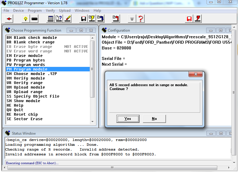

I am trying to flash .phy file of my Bootloader software using Cyclone pro through PROG12Z tool.
when I flash my code through CodeWarrior IDE debug mode my code runs without any problem.
But when I try to flash .phy file the PROG12Z tool is throwing the following error,
For your information I am using the burner file attached, to compile using the IDE CodeWarrior.
Well I use the algorithms to erase and link are as mentioned below,
Freescale_9S12G128_1x16x2k_4k_EEPROM.12P
Freescale_9S12G128_1x16x64k_128k_Linear_Pflash.12P
Please let me know why am I getting Invalid address in srecord block?
Is it related to burner file? If yes, I request you to provide me the burner file needed for S12G micro.

Hi Ganesh,
Please try and convert the .phy file you use with PEMicro's Log2phy tool:
PEMicro Blog
or SRecCvt tool:
SRECCVTSW (REV 1.0.31)
p.s. The burner file for S12G devices generated by CW was not correct as it was taken from older MCUs. That was reported and fixed. The one you attached differs from a random one i took from a CW project (see attached0).

Hello Iggi,
The burner.bbl file you have attached above has resolved the problem.
I appreciate your  support.
